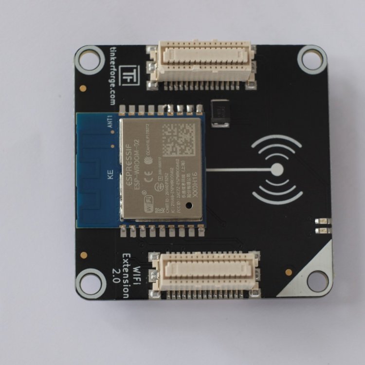

rtrbt Geschrieben December 17, 2021 at 13:09 Share Geschrieben December 17, 2021 at 13:09 I'm currently trying to reproduce this. So far the WiFi connection still works. Is this just some dirt or a bit of solder? Can you scrape it away? (Just to make sure this does not short-circuit anything) Zitieren Link zu diesem Kommentar Share on other sites More sharing options...
Superp Geschrieben December 17, 2021 at 13:43 Autor Share Geschrieben December 17, 2021 at 13:43 That is why I uploaded the image. The four rightmost contacts look like they have been hand-soldered, post assembly. There are also traces of heating visible on the board. The speck looks metallic. It is firmly stuck on the 5th pad from the right. [...] I scrapped it off, it is a tiny bit of metal. [...] Flashing the extension to 2.1.5 [...] Flashing the extension to 2.1.6 (!!) More to follow Zitieren Link zu diesem Kommentar Share on other sites More sharing options...

rtrbt Geschrieben December 20, 2021 at 09:00 Share Geschrieben December 20, 2021 at 09:00 Hi, The new firmwares only fix unrelated problems, for example 2.1.5 fixes the LED issue you've found. On 12/17/2021 at 2:43 PM, Superp said: The four rightmost contacts look like they have been hand-soldered, post assembly. Yeah, this does not look perfect. Are the WiFi problems also happening with the other extension? If yes, I would assume that they are not caused by bad soldering. Some questions to find out on which level this is broken: If you configure an extension to the Client + AP mode the status LED should be blinking continously. When the stack becomes unresponsive, does the LED still blink? When a stack becomes unresponsive, and you plug in a USB cable, can you still reach the stack on localhost via USB? On 12/15/2021 at 2:47 PM, Superp said: I have also tried postponing first connection for 10 minutes after booting. First connection after 10 minutes also results in timeouts, so the stack "hangs" by itself (?). Did you only postpone TFP connections or also pings etc? Another idea: Does this also happen if you don't connect the stack to your network at all, but instead only use its access point? Zitieren Link zu diesem Kommentar Share on other sites More sharing options...
