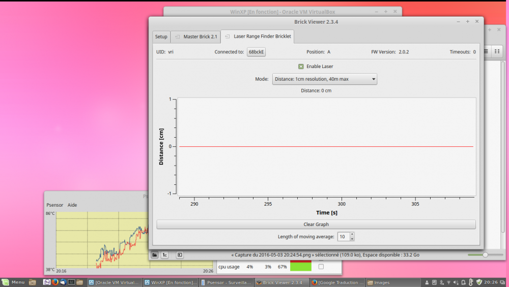

benoit Geschrieben May 1, 2016 at 10:02 Share Geschrieben May 1, 2016 at 10:02 Hi all, I just receive my Laser Range Bicklet and I have a problem with it. It runs 5 to 10 minutes and then stopped working. If I disconnect and reconnect the cable or move the cable, some times it works again for a few minutes. I tried several cables on several Master Brick but without success Master Brick : 2.1 FW 2.3.4 Laser Range : 2.0.2 Does anyone has had this kind of problem? Zitieren Link zu diesem Kommentar Share on other sites More sharing options...
borg Geschrieben May 2, 2016 at 16:06 Share Geschrieben May 2, 2016 at 16:06 What does stop working exactly mean? Do you still get a value but it is wrong? Does the stack completely freeze? Zitieren Link zu diesem Kommentar Share on other sites More sharing options...
benoit Geschrieben May 3, 2016 at 18:32 Autor Share Geschrieben May 3, 2016 at 18:32 thank you for the answer. no the stack works properly but the value of the laser range bricklet remains at 0 Zitieren Link zu diesem Kommentar Share on other sites More sharing options...
jforge Geschrieben May 8, 2016 at 18:06 Share Geschrieben May 8, 2016 at 18:06 Same here since some weeks, but now i know _my_ problem and it seems to be different: Normally I believe in trivial personal problem with such suprising behaviour. And I remember problems connecting a bricklet cable (it's a bit difficult with the Laser Range Finder -> could be improved in my point of view). => I bent a pin of the bricklet connector header :-( Q: Is it possible to replace the connector header by myself? If yes, is there any good advice to do it right? Description of the bricklet behaviour during newbie debugging: The bricklet was always detected, but provided 0 values. Updating the bricklet (from fw 2.0.1 to fw 2.0.2 was not possible (Timeout). After such timeouts, the whole stack was not functional anymore until the next reset.Repeated attempts for a bricklet update finally were successful (5 attempts).But this didn't change the behaviour (masterbrick 2.0, 2.1 w/ LRF 2.0.1, 2.0.2) Zitieren Link zu diesem Kommentar Share on other sites More sharing options...
photron Geschrieben May 10, 2016 at 07:50 Share Geschrieben May 10, 2016 at 07:50 benoit, please check the black cables that connected the sensor to the PCB. Are they properly seated in the black press fit connector on the PCB? Q: Is it possible to replace the connector header by myself? If yes, is there any good advice to do it right? You need the proper soldering equipment to do it. A simple soldering iron won't help you much. How badly is the pin bend? If the pin is only slightly bend you can straighten it again. But you can also ship the Bricklet back to us and we'll replace the connector for you. 1 Zitieren Link zu diesem Kommentar Share on other sites More sharing options...
