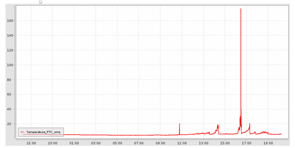

xsherlock Geschrieben October 23, 2015 at 06:25 Geschrieben October 23, 2015 at 06:25 Every week or so a temp sensor that sits on a wall of my not so hot house , comes up with a readout that should not happen. In openhab it screws up autoscale graphs. I could add filtering rule but that should not happen in the first place. mysql> select * from Item4 where Value >30 -> ; +---------------------+-------+ | Time | Value | +---------------------+-------+ | 2015-10-12 21:47:03 | 80.93 | | 2015-10-21 01:23:41 | 48.93 | +---------------------+-------+ 2 rows in set (0.08 sec) Zitieren

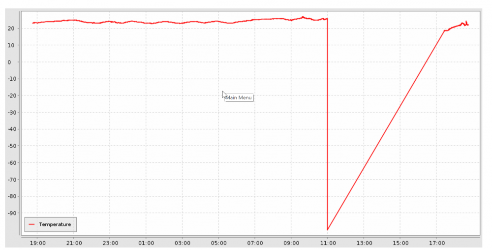

xsherlock Geschrieben January 17, 2016 at 21:02 Autor Geschrieben January 17, 2016 at 21:02 Theo, Is the Tinkerforge addon distributed with Openhab 1.8.0 the same you gave me for download? I did upgrade to 1.8, by uninstaling and doing a proper apt-get 1.8, then overwritten the configs with my tried and working 1.7 setup and I get the negative -100 values again. Twice in the last 3 days. And now it is even worse as the redbrick I have sensor attached stops responding at all. hanging up the readout until I reboot. Zitieren
