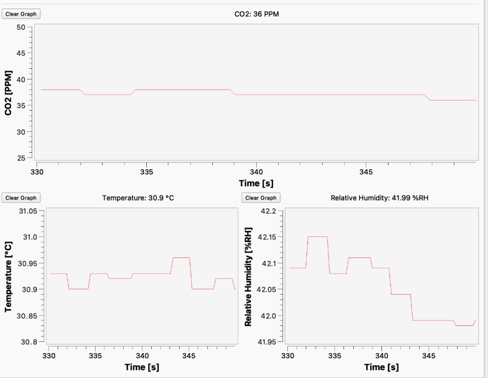

Wailer Geschrieben September 10, 2024 at 15:16 Share Geschrieben September 10, 2024 at 15:16 Hi, I have a tinkerforge weather station to which I added a CO2 bricklet, among other sensors. Recently, the CO2 bricklet has started displaying inaccurate values, sometimes dropping to 0 ppm, even though the minimum reading should be around 400 ppm. Do you have any idea what might be causing this issue? Should I consider replacing the bricklet? Zitieren Link zu diesem Kommentar Share on other sites More sharing options...

Wailer Geschrieben September 11, 2024 at 08:47 Autor Share Geschrieben September 11, 2024 at 08:47 (bearbeitet) Yes, it used to calibrate to 400 ppm and it didn't drop below that. But now it drops to 0 ppm. It's been like that for weeks. Note that the values still vary in a meaningful manner, but the minimum value is now 0 ppm rather than 400 ppm. bearbeitet September 11, 2024 at 08:54 von Wailer Zitieren Link zu diesem Kommentar Share on other sites More sharing options...
borg Geschrieben September 11, 2024 at 09:05 Share Geschrieben September 11, 2024 at 09:05 Strange. Have you tried turning it off for a a few hours and then on again? Zitieren Link zu diesem Kommentar Share on other sites More sharing options...
Wailer Geschrieben September 12, 2024 at 09:41 Autor Share Geschrieben September 12, 2024 at 09:41 Yes, I did and it's still the same. Zitieren Link zu diesem Kommentar Share on other sites More sharing options...
