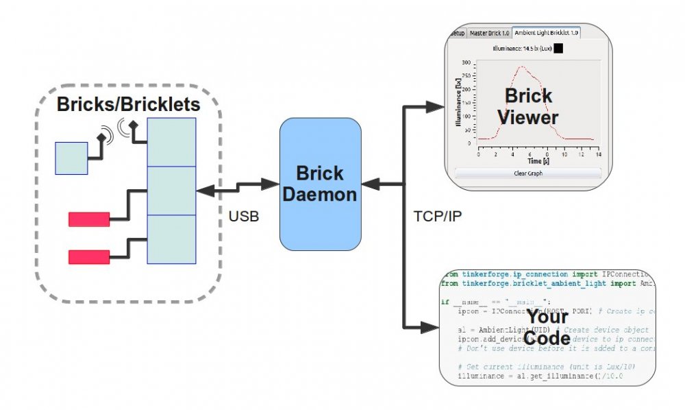

borg Geschrieben March 28, 2012 at 18:06 Geschrieben March 28, 2012 at 18:06 1. Concise description of the software architecture (on a Linux host) It is fairly simple. We have a Brick Daemon, a Brick Viewer and language bindings. The daemon has a USB connection to the Bricks (and over the Bricks to the Bricklets) and opens a TCP port. The bindings (currently for C/C++, C#, Java, Python) speak over TCP with the Brick Daemon and provide an API to the user (like SetSpeed, GetTemperature, etc). That is in principle all you need to use Bricks and Bricklets (the Brick Daemon and one language binding). Additionally we have the Brick Viewer, that provides a GUI for all of the API for all Bricks/Bricklets. The idea is to use it for testing before you start your own project. 2. Concise description of the capabilities of the 'Bricks' A list of devices that we currently have can be found here: http://www.tinkerforge.com/doc/index.html#bricks You can click on the names to get an in depth description. Zitieren
